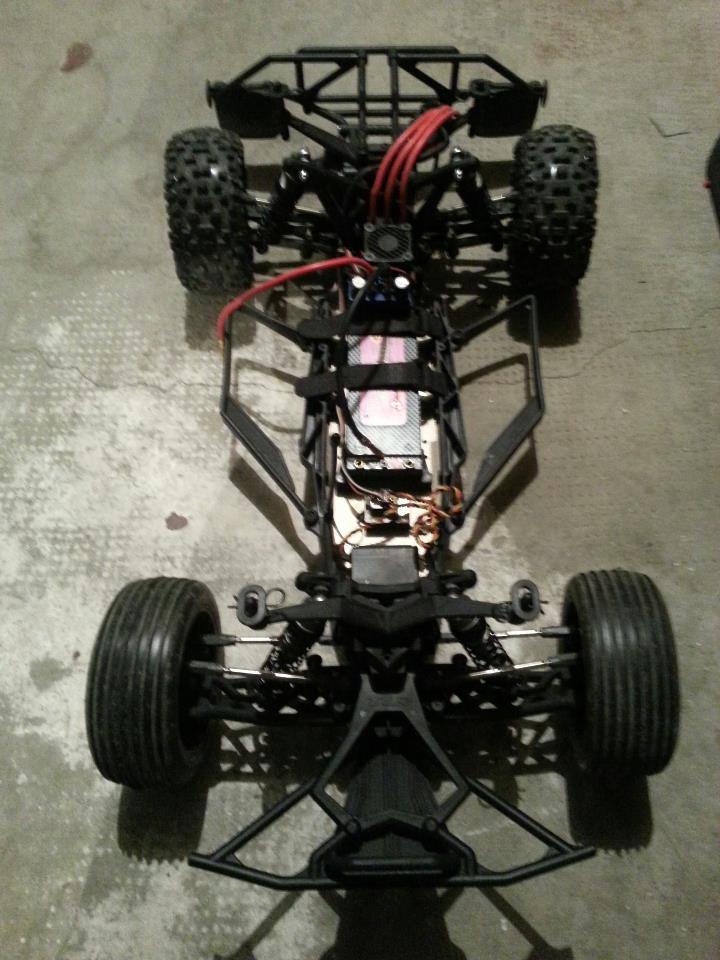

Message  papydodu05 Lun 15 Avr - 13:22
Le Losi 22SCT de Alain Dheilly avec un combo ix8 lrp moteur lrp dynamic 10 3800kv
[img]1/10 22 2WD race buggy kit TLR0022  52181210[/img]
[img]1/10 22 2WD race buggy kit TLR0022  54151310[/img]
[img]1/10 22 2WD race buggy kit TLR0022  52951410[/img]
[img]1/10 22 2WD race buggy kit TLR0022  52165910[/img]
[img]1/10 22 2WD race buggy kit TLR0022  54075810[/img]
